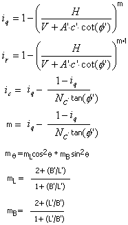

    • For conditions with drainage, formula B.2:
      Dimensionless factors of the load capacity are equal to:
      Dimensionless factors of the shape are equal to:
      Dimensionless factors of the load inclination resulting from the horizontal force H parallel to the longer and to the shorter sides, respectively, are equal to:
      Coefficients of the foundation depth equal:
      where:
      where:
