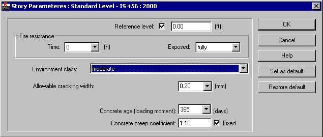

Use this option to define parameters of a story according to the Indian RC code IS 456:2000. There are two ways to access the option:
- Select Analysis menu > Story Parameters,
- Click the
icon in the Story Parameters toolbar.
The following dialog displays:
Options describing a story:
- Reference level - a level of the top surface of a beam; it is an additional parameter in a beam drawing.
- Fire resistance
- Environment class
- Allowable cracking width
- Concrete age (loading moment) and concrete creep coefficient.
The dialog has standard buttons (OK, Cancel, Help), and:
- Set as default - to save story parameters in this dialog as default
- Restore default - to restore default settings of the parameters defined in the Calculation Options dialog.
To save particular story parameters as default:
- Set the appropriate story parameters,
- Click Set as default.
