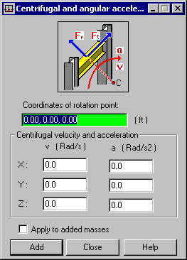

Centrifugal and angular acceleration forces
This option defines loads caused by centrifugal and angular acceleration forces. Open the dialog by clicking in the Load Definition dialog.
This type of load is a static load that considers added masses. This load generates centrifugal and angular acceleration forces caused by element mass and masses added in nodes or elements. The following forces are generated:
Parameters of this load type include:
It is assumed that the orientation of the generated centrifugal force is directed outward from the central point. Generation of the tangent force orientation is consistent with the direction of rotation. That is, if a positive value of acceleration is defined, tangent forces are consistent with dextrorotatory rotation about a given axis.
This type of load can be applied to structure displacements on the sea caused by pitching and heaving of a ship or platform.
