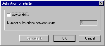

Click Define Parameters to define parameters of the shifting procedure. If Active shifts option is deselected, the procedure will be activated. The number of iterations between two successive shifts is treated as the parameter of this procedure.
Click Set default to assume the default value of the iteration number. If the method with shifts is to be used, deselect Active shifts and click OK.
Note: Avoid setting an excessively small number of iterations between successive shifts. It leads to frequent reinforcement-aggregation and decomposition of the shifted stiffness matrix Kσ. These are particularly time-consuming operations, especially in the case of big structures.

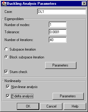

To select the method of block subspace iteration for buckling analysis of a structure, click Change analysis type in the Analysis Type dialog (for the selected load case) and select the Buckling option in the Analysis Type Change dialog. Click OK to access the parameters dialog for buckling analysis and select the block subspace iteration method.
