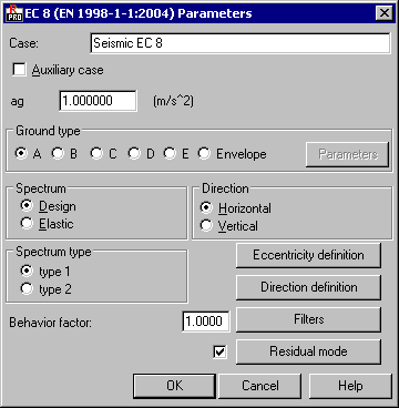

Parameters of a structure seismic analysis depend on a seismic code used during calculations of a structure influenced by seismic impact. Select seismic code EC 8 (EN 1998-1:2004) in the New Case Definition dialog or click Parameters in the Analysis Types dialog.
To complete the seismic analysis according to the rules given in a code, define the following parameters.
- Value of ag - It specifies the design ground acceleration on type A ground as specified by Local Authorities. The design ground acceleration is defined in terms of the reference peak ground acceleration on type A ground agR and importance factor γ derived from the building class:
ag= γ × agR.
- Ground type (A, B, C, D or E), as specified in the Table 3.1. It specifies parameters of the ground type influence that describe the response spectrum (S, Tb, Tc and Td) according to the tables 3.2, 3.3 and 3.4.
If the Envelope option is selected, the Parameters button becomes accessible; click it to open the Spectrum Envelope dialog.
- Spectrum (design, elastic), as specified in point 3.2.2.
- Direction (horizontal, vertical)
- Spectrum type (type 1, type 2), as specified in point 3.2.2.
- Value of the Behavior factor (q). According to point 3.2.2.5, this is a reduction factor of the design response spectrum in relation to the elastic response spectrum. You can edit its value after selecting the Design spectrum option.
Note: The behavior factor q reduces the design spectrum; this way it also decreases seismic loads and the resulting internal forces. However, as specified in point 3.2.2.5, the displacement based on the design response spectrum is multiplied by the behavior factor q. Thus, usually such displacement is not reduced in relation to the elastic response spectrum.
Click Eccentricity Definition to open the Definition of mass eccentricities dialog where you can specify how to account for the eccentricity of a mass in the seismic analysis
In the lower part of the dialog, the Direction definition, Filters, and Residual Mode buttons are located.
