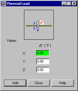

Thermal Loads
This option defines thermal loads acting on structure bars. Open the Thermal Load dialog by clicking on the Bar tab in the Load Definition dialog.
You can define a thermal load applied to a structure bar, acting in the X, Y, or X direction of the local bar coordinate system in this dialog.
dTy and dTz values refer to the differences in temperature between the extreme fibers of a cross-section through an element (in the direction of the Y or Z axis of the local coordinate system, respectively). The dTx value (or dT, the 2 symbols are equivalent) denotes uniform temperature distribution (heating or cooling down) of an entire element.
