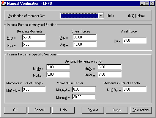

Use the Manual Verification dialog to manually verify the steel member for values defined by the user according to the requirements of the American Steel Code LRFD. Access the dialog by clicking Analysis > Bar Structure Design >Steel\ Aluminum Members Design >Manual Calculations. The following dialog displays:
Member verification is performed by assigning the force values appropriate for calculations. The dialog is divided into two main parts:
Click the Robot button to select values from a load case list. Appropriate force values will automatically be entered in the corresponding fields of the Manual Verification dialog.
To perform verification of a member acted upon by internal forces defined by the user, you should:
After the Calculations option is selected, member verification will be performed. After they are completed, a dialog displays the results.
