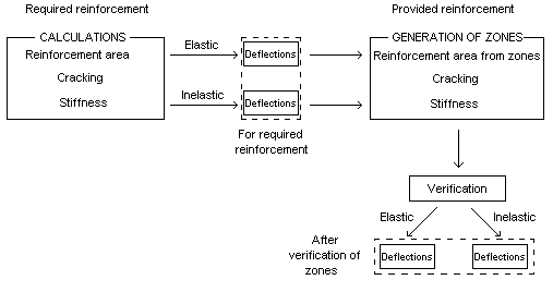

When reinforcement area, cracking, stiffness and deflection are calculated, verification of the reinforcement area from zones takes place. Verification is performed to obtain the final value of deflections. New areas are the basis for recalculation of cracking and stiffness values. See Methods of calculation of deflections in plates / shells for more information on calculation algorithms of individual methods.
Verification (like calculations of required reinforcement) can be performed using either of the following methods.
