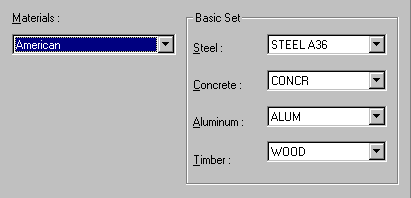

Click the Tools menu > Job Preferences > Materials to open the Materials dialog.
From the Materials drop-down list, you can select by country the materials to be used in the structure design. Click Modification to define or modify a material.
You can define the basic set of materials used during structure analysis:
Specifies the types of steel that are available by country (Materials field).
Specifies the classes of concrete that are available by country (Materials field).
Specifies the types of aluminum that are available by country (Materials field).
Specifies the types of timber that are available by country (Materials field).
