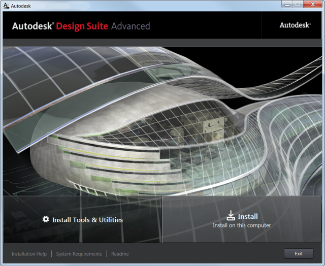

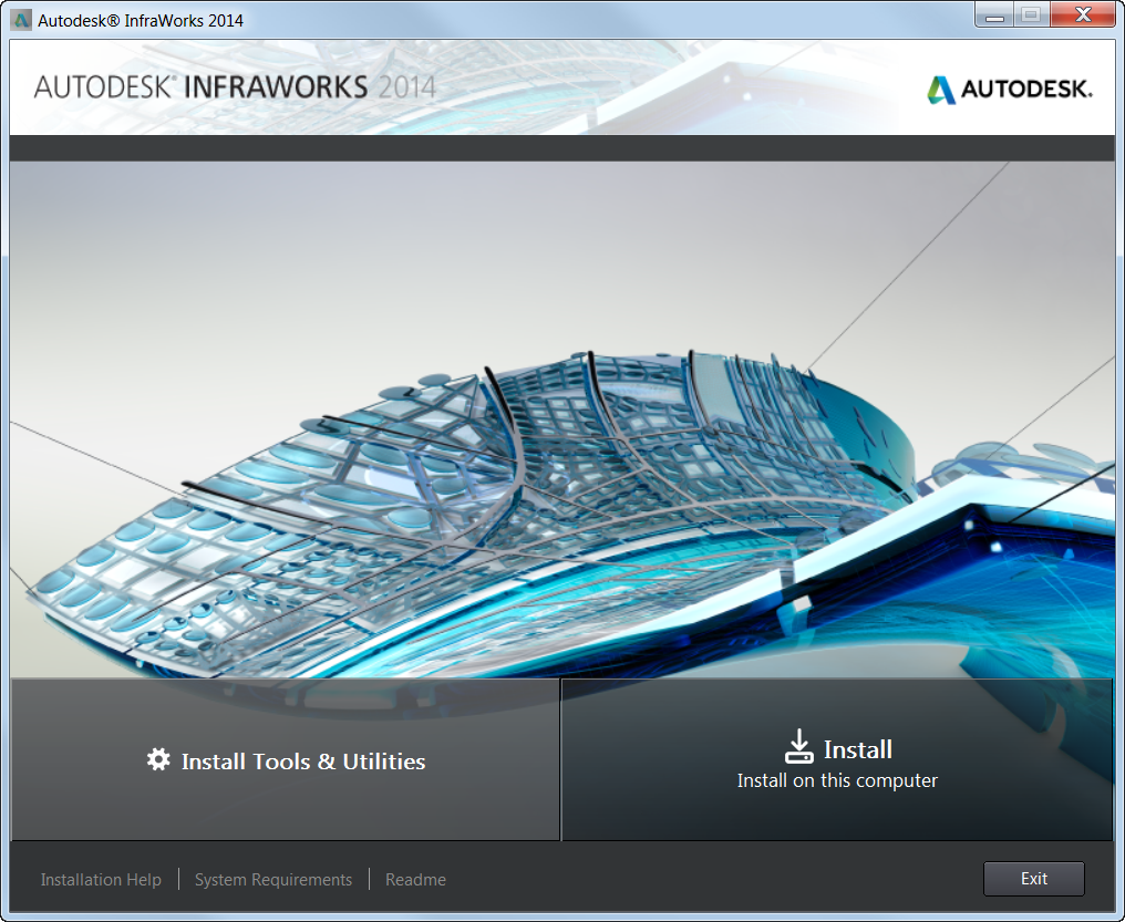

    Sample Autodesk Installer
  2. In the installer window, click Install.
