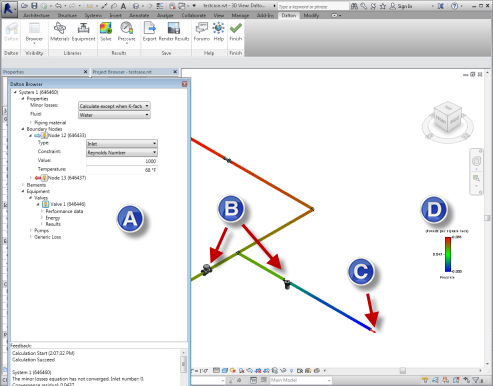

Use the Dalton Browser (A) to browse through the Properties, Equipment (B), Boundary Nodes (C) and Elements of the circuit.
(Show me) to zoom on the selected system element. This allows you to better visualize equipment or specific areas in the distribution system. When results are available for the distribution system, a legend (D) is displayed which allows you to better understand the simulation results.
