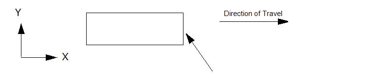

An example of assigning linear direction:
Select either a Global direction or the Select Surface button, and select the surface normal to the direction of travel.
The specified direction of travel is the reference direction, and all directional-dependent parameters are relative to it. Specified positive displacements will move the object in the reference direction. Negative displacements will move the object in the opposite direction.
