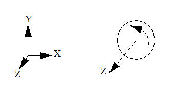

Axis of Rotation
Either key in a vector or use the pop-out to set the axis of rotation. The rotational direction uses the right hand rule convention.
Choose the Global X, Y, or Z axes to choose a Cartesian direction as the axis of rotation.
To graphically set the direction, click the Select Surface button, and select a surface. The axis will be normal to the selected surface.
For example:
The desired axis of rotation is the Global Z, and the rotation direction is positive.
Either enter a unit vector of 0,0,1 or open the pop-out and click the “Z” button, or select the surface normal to the Z button.
The Direction of Rotation is the reference direction for all directional-dependent parameters. For user-prescribed rotation, a positive angular rotation will rotate the object in the Direction of Rotation. A negative angular rotation will rotate the object in the opposite direction.
Flow-driven parameters such as driving torque and resistive torque reference this direction as well. Positive values of a driving torque will act in the direction of the Axis of Rotation; negative values will act in the opposite direction. In contrast, positive resistance forces will act in the opposite direction of the Direction Vector; negative resistance forces will act in same direction as the Direction Vector.

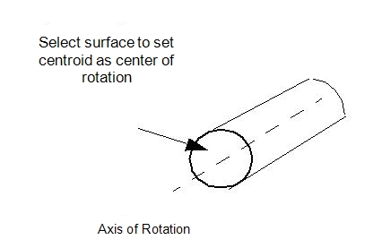

Center of Rotation
The center of rotation is the point through which the axis of rotation passes. There are two ways to specify it:
To specify the centroid of a surface, open the pop-out, click the Select Surface button, and select the surface.
The axis of rotation will pass through the centroid of the selected surface:
