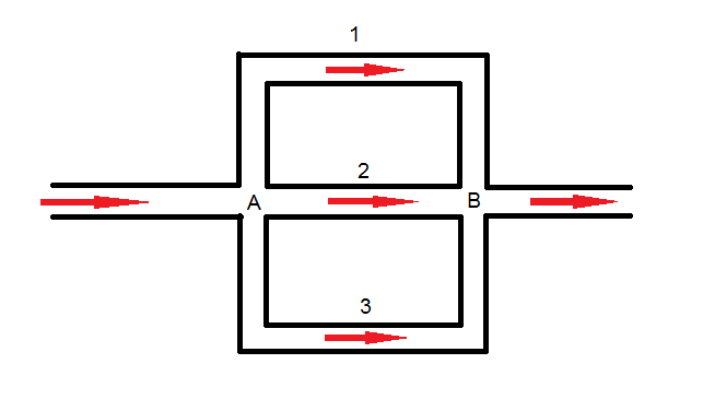

With parallel connections, the distance that the fluid must travel can be longer in certain regions of the network. In the figure below, more fluid will flow through branch 2, because the flow always follows the path of least resistance.
In this case the total flow through the network is the sum of all three branches.
