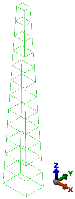

  4. Select  View Navigate Orientation Isometric View.
    The tower should display as shown in the following image.
