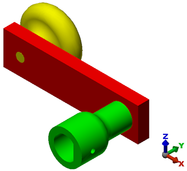

  2. Select the directory where you want the file to be extracted and click OK. The model opens in the FEA Editor environment, as shown below.
