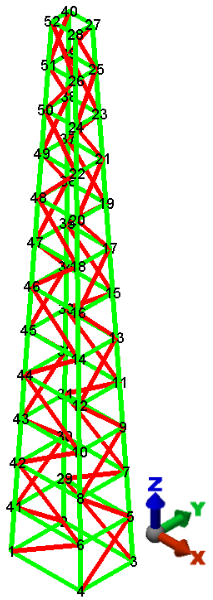

  4. Activate the Results Options View Show Numbers Node Numbers option. Your model should look similar to the one shown in the following image.
  5. Write down the node numbers of the four top nodes of the model, as shown on your display.
