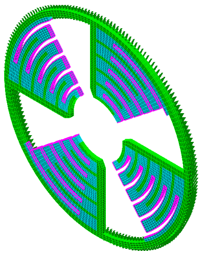

We will now visually verify the Coulomb force calculation surface and then set up the force calculation.
  1. Click the  Home icon above the ViewCube for an isometric view of the model.
  2. Right-click the Part 2 heading in the browser and clear the Visibility option. The rotor will no longer be displayed.
  3. Expand the list of surfaces under Part 3 by clicking the "+" sign to the left of the Surfaces heading.
    • Select Surface 5 < Unnamed >. All of the rotor contact surfaces for the air (Part 3) are magenta, indicating that they have been selected, as shown below.
  4. Right-click the Part 2 heading in the browser and enable Visibility.
