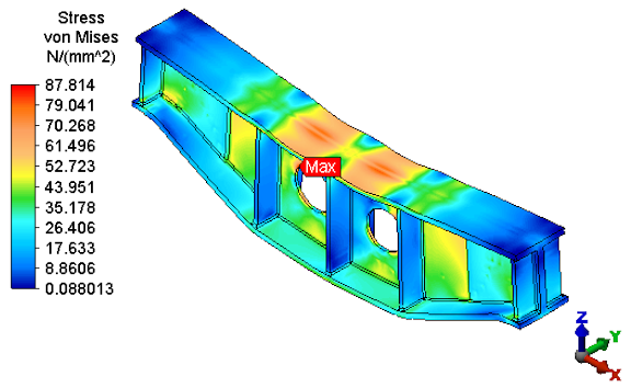

    After solid meshing, the analysis proceeds and the model displays in the Results environment. The maximum non Mises stress is now approximately 88 N/mm2, which is below the allowable stress of 90 N/mm2. The stress results appear as shown in the following image.
    Note: The selection of the von Mises Stress results and the activated state of the Maximum results probe have been retained from the previous analysis session.

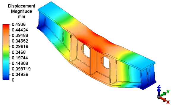

  3. Click Results Contours Displacement Displacement Magnitude. The maximum displacement is now slightly less than the allowable displacement of 0.5 mm, as shown below.
