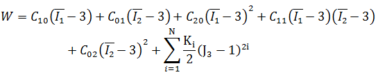

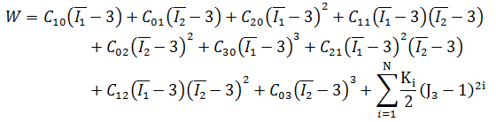

The potential function of the material for different orders is as follows:
2-constant standard:
5-constant high-order:
9-constant high order:
Regardless of the order, the initial shear modulus, µ0, and the bulk modulus, k0, depend only on the polynomial coefficient of order N=1:
μ0 = 2(C10 + C01) , k0 = K1
