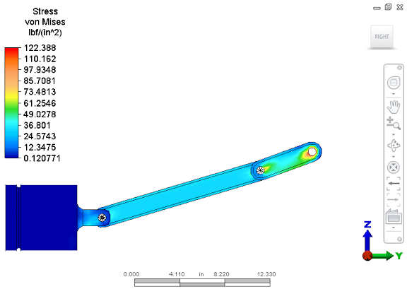

    • Click OK. The results at 0.556 seconds will be displayed and the piston will be partially off-screen.  We want to set the display area so that the entire model will remain visible throughout the animation. Currently, the model is extended to its furthest position in the -Y direction.
  2. Use the View Navigate Zoom Zoom command to zoom out until the entire assembly is visible and there is ample room for the crank to make its full rotation without extending off of the screen. Click in the display area and drag downward to zoom out (upward to zoom in).
    • You may also have to pan the view to properly position the assembly within the display area. You can do this without terminating the zoom mode by holding down the Ctrl key while clicking the middle mouse button and dragging.
    • Press Esc to exit the zoom mode. The model should be positioned approximately as shown in the following image:
