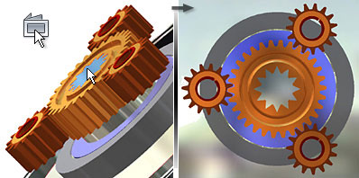

Use Look At to zoom and rotate the model in the graphics window. You can choose from three different Look At functions:
- Look At : Positions the selected planar element parallel to the screen or positions the selected edge or line horizontal to the screen.
- Look At Point : Centers, rotates, and zooms the display to position the elements around the selected point normal to the screen.
- Look At Surface: Creates a best-fit plane through the selected surface and positions the plane parallel to the screen. Also, zooms the display to enclose the surface.
