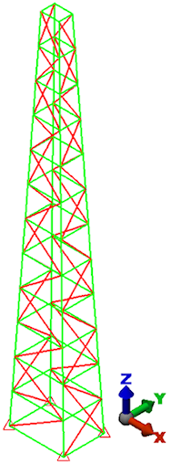

    • Select the directory where you want the file to be extracted
    • Click OK. This archive includes the results of the prerequisite modal analysis.  The model opens in the FEA Editor environment, as shown below.
