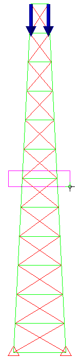

Apply the Forces in the -X Direction
Now we will apply the four 175 lbf forces in the -X direction to the center of the model.
  1. Click and drag to draw a box enclosing the center of the model as shown in the following image.
  2. Click Setup Loads Force.
    • Type -87.5 in the Magnitude field
    • Select the X radio button. Again, we have cut the force in half because there are two nodes at each vertex, one per part.

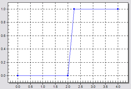

  3. Type 2 in the Load Case / Load Curve field and click the Curve button. The Multiplier Table Editor dialog box displays to define a load curve.
    1. Click Add Row three times so that there is a total of four rows in the table.
      • Type 2 in the second row of the Time column.
      • Type 2.25 in the third row of the Time column
      • Type 1 in the third row of the Multiplier column.
      • Type 4 in the fourth row of the Time column.
      • Type 1 in the fourth row of the Multiplier column.
    2. Press Enter. The load curve should appear within the dialog as shown below.
    3. Click OK to accept the load curve.
