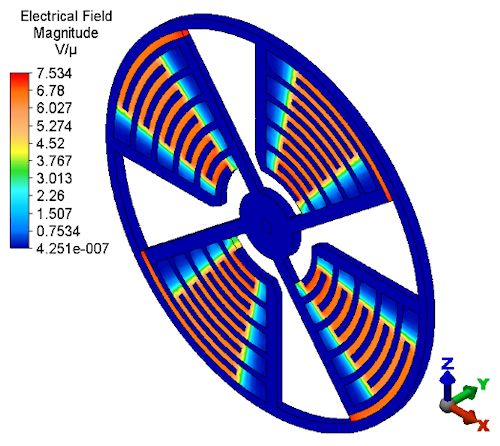

  1. Click Results Contours Voltage and Field Strength Electric Field Magnitude. The electrical field magnitude results should look as shown in the image below.
  2. Right-click the heading for Part 2 in the browser (tree view) and click Visibility to hide the rotor.

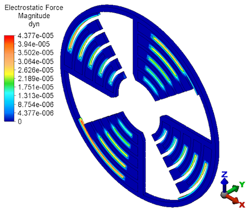

  3. Click Results Contours Voltage and Field Strength Electrostatic Force Magnitude. The electrostatic force results appear as shown in the following image.
  4. Right-click the heading for Part 2 in the browser and click Visibility to show the rotor.
