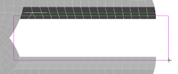

  2. With the Selection Shape Point or Rectangle and  Selection Select Surfaces commands active, click and drag to draw a box enclosing the gripping surfaces, as shown in the following image.
  3. Click Setup Constraints General Constraint.
    • Click the Fixed button.
    • Click OK.
