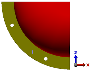

  3. With the  Selection Shape Point or Rectangle command active, click the surface of the flange facing the screen, as shown highlighted in the image below.
    • Click  the Add button to the right of  the Contact surface(s) box in the Bolt head section.
    • Type 0.85 in the Head diameter field.

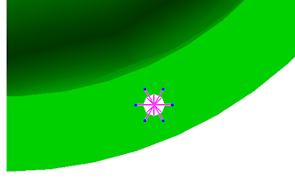

  7. Type 30 in the Axial Force Magnitude field.
    • Activate the Do not dismiss dialog after bolt generation check box.  We will want to create a second bolt using identical parameters, except for the interior hole surfaces. Checking this box keeps the dialog open and retains all needed parameters so that the second bolt can be more easily created.
    • Click OK. The first bolt appears as shown below. The bolt has been selected for better visibility.
