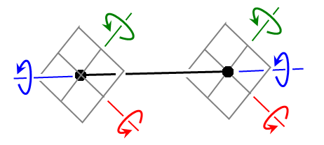

There are three parameters that can be used to control the rotational behavior of actuator elements. For the axial rotation of the slave node to follow the axial rotation of the master node, activate the Couple axial rotations of two ends of element check box in the Constraints tab of the Element Definition dialog. This check box will be available when only the distance (displacement) of the actuator is being controlled. It will not be available when the rotation angle of the actuator is being controlled. The two rotations perpendicular to the actuator element, or the planar rotation of the slave node relative to the master node, can be forced to be equal by activating the Couple planar rotations of two ends of element check box in the Constraints tab of the Element Definition dialog. See Figure 1.
Figure 1: Coupling Rotations at Actuator Ends
By default, the connections between the actuator element (black) and structure (gray) behave like ball joints; the structure at each end can rotate in all three directions independent of each other. If the Couple axial rotations of two ends of element option is activated, then a torque is transmitted through the actuator so that the axial rotation angle (blue arrows) of the structures attached to each end is identical. If the Couple planar rotations of two ends of element option is activated, then a moment is applied at each end of the actuator so that the perpendicular rotation angles (green and red arrows) of the structure attached to the actuator are identical.
Naturally, the rotations of the structure attached to the actuator can be controlled only if the elements of the structure have rotational degrees of freedom, such as beam and shell elements.
