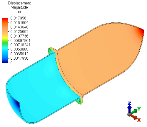

Click  Analysis Analysis Run Simulation.
After solid meshing, the analysis proceeds. When finished, the model displays in the Results environment, as shown below. By default, the displacement magnitude is presented initially.
The displaced shape of the model is exaggerated, so the pressure vessel does not separate as much as displayed. The maximum displacement is approximately 0.0175 inch.
