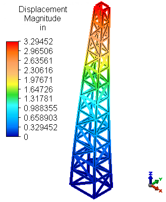

If the annotation in the lower left corner does not say Load Case: Resultant of 5, then click Results Options Analysis Specific Resultant. The displacement magnitude shown is the resultant of the displacements for the five natural vibrating modes. The maximum displacement magnitude is 3.29 inches, as shown in the following image.
