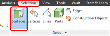

1. From the ribbon, click Selection Select Surfaces.

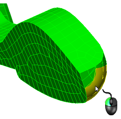

Contact Pair 1:
2. Rotate the view as needed to see the surface on the first part, as shown below. Then, select this contact surface on the first part.

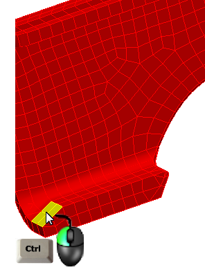

3. Hold Ctrl, and also select the contact surface on the second part, as shown below. (Rotate the view as needed to see this surface.)

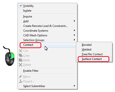

4. Right-click, and select Contact Surface Contact.

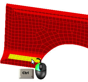

6. Rotate the view as needed and select the contact surface from the first part, as shown below. This is the same surface that was selected in Step 2 except that this time, we will pair it with a different surface on the second part.
7. Rotate the view as needed. Then, hold Ctrl and select the contact surface from the second part, as shown below.

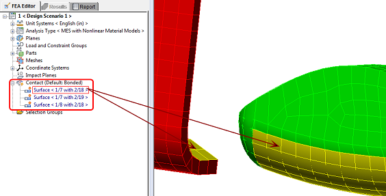

What it should look like...
Note: You'll need to rotate the view to inspect each contact pair.
Tip: When you hover the cursor over one of the Surface contact pairs listed in the browser, the corresponding surfaces on the model are highlighted in yellow.
