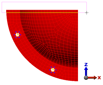

  2. With  the  Selection Shape Point or Rectangle and  Selection Select Surfaces commands active, click and drag to draw a rectangle enclosing the top edge of the model, as shown below.
  3. Click Setup Constraints General Constraint.
    • Click the Z Symmetry button.
    • Click OK.

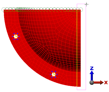

  4. Draw a selection rectangle enclosing the right edge of the model, as shown below.
  5. Click Setup Constraints General Constraint.
    • Click the X Symmetry button.
    • Click OK.

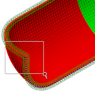

  7. Select  View Navigate Zoom Window. Draw a box around the bottom corner of the pressure vessel to zoom into this corner, as shown in the following image.
    • Press Esc to exit the zoom area command.

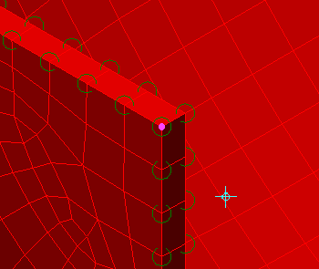

  8. With the  Selection Select Vertices command active, click the node at the bottom corner of the model, as shown highlighted below.
  9. Click Setup Constraints General Constraint.
    • Click the Fixed button.
    • Click OK.
