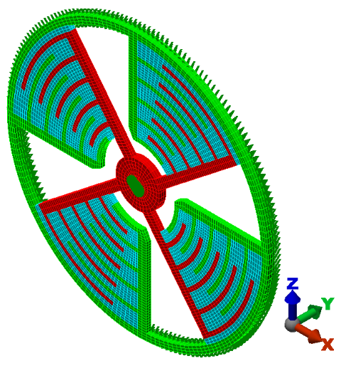

  2. Select the file, Radial Comb Electrostatic Results.ach, and click Open.
    1. Select the directory where you want the file to be extracted.
    2. Click OK. The model opens in the FEA Editor environment, as shown below.
