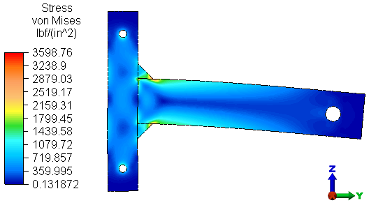

We will now look at the von Mises stress.
  1. Click Results Contours Stress von Mises. The maximum value is approximately 3,591 psi.

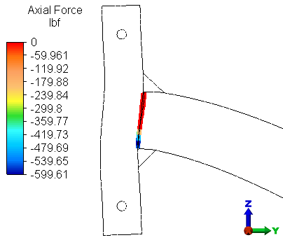

  4. You can also see the distribution of the contact force by selecting Results Contours Other Results Element Forces  Axial Force.  All results are either zero (no contact) or negative (compression), with the greatest force being at the bottom, as shown below.
