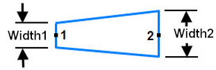

(a) Quadrilateral section.
(b) Arc section.
Figure 7: Example Strips
For each strip, define the YY and ZZ coordinates of each point and the width of the segment at that point. The YY coordinate refers to the beam's local 2 axis and the ZZ coordinate refers to the local 3 axis. Both dimensions are measured from the calculated center of gravity of the cross section. he center of gravity of the final shape lies on the beam element's axis. The YY and ZZ coordinates should correspond to the midpoints of the strips.
Tip:
The Preview window on the Element Definition dialog shows the strips as the data is entered. Note the following features of the Preview window:
  • The strip that corresponds to the row with the cursor is highlighted. Move the cursor to a different row of the spreadsheet to view each strip.
  • Rotate the mouse wheel to zoom the Preview window in and out.
  • Hold and drag the left mouse button to pan the Preview window.
  • Right-click and choose Enclose View to see the entire sketch.

Four additional cross-sectional geometry types are shown in Figure 9. In all the diagrams, the lines represent a thickness.
(a) (b) (c) (d)
Figure 9: Additional Cross-section Geometry Types
Cross-section (a) will require three sections, one for each rectangle. The rectangle on the left will need to be drawn using five indices. The right vertical line must be split into two indices so that they can be defined to be in common with the other two sections. Since common indices must be defined in both sections, this cross-section will require a total of thirteen indices. Cross-section (b) will require two sections. Each rectangle must be defined with the center piece defined as common in both sections. This cross-section will require eight indices. Cross-section (c) will require three sections. Since the two rectangular tube sections are closed sections, they must be defined separately. No indices will be defined as common between any of the sections. This cross-section will require nine indices (it is not necessary to split the sides of the two rectangle where the horizontal piece connects. Cross-section (d) will only require one section. This cross-section will require three indices.
