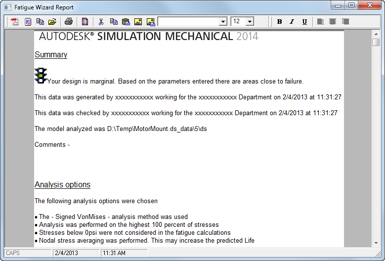

Report Writer
The Report Writer operates like most modern word processors. The report view emulates the paper size you select (Letter, A4, and so on), and is a WYSIWYG view. Almost all of the report is written automatically. You can edit the report.
Icons
PDF Export - Creates an Acrobat PDF file.
RTF Export - Exports a file into various programs.
Copy all to Clipboard - Copies the entire report to the Windows clipboard.
Open previous - Opens a previously saved report.
Print - Prints immediately to the currently defined printer.
Setup - Controls various page/print/pdf options.
Cut/Copy/Paste - Applies to selected text or graphics. Also available on the right-click menu.
Insert Current Picture - Inserts the current picture in the Step 9 graphics region.
Insert picture from file - Inserts the selected file (BMP, GIF, JPG, and so on).
