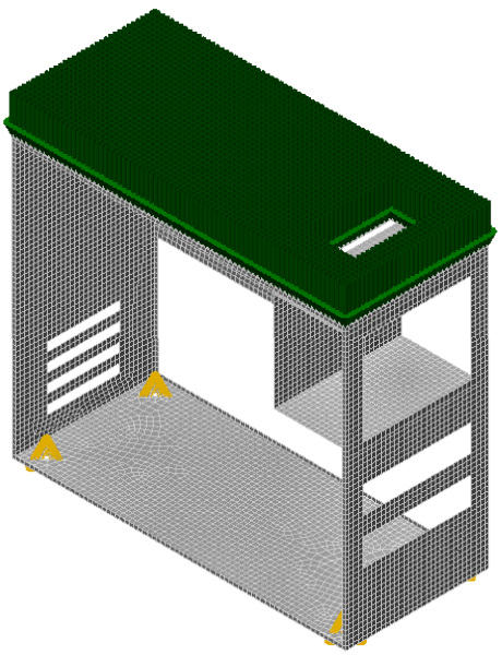

  1. With the  Selection Shape Point or Rectangle and  Selection Select Surfaces commands active, click the surface at the top of the computer case.
  2. Click Setup Loads Force.
    • Type 50 in the Magnitude field.
    • Select the Custom radio button.
    • Type -1 in the Z field.
    • Click OK
  3. Press Esc to clear the surface selection. The model displays as shown in the following image.
Tip: Applying a force of -50 in the Z direction will give the same results as applying a force of 50 in the -Z direction. However, the load will be rendered differently for each. One will be drawn with the arrow end of the load attached to the surface. The other method will be drawn with the tail end of the load attached to the surface. When capturing images, choose the load application method that produces the best visual results.
