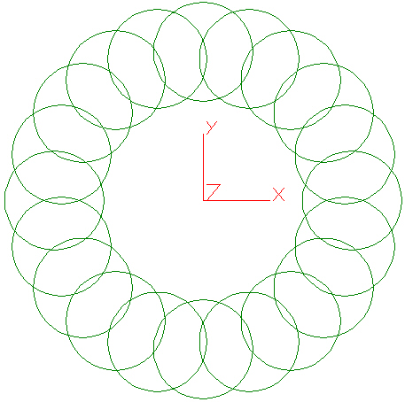

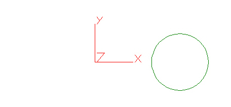

However, if you have the circle as shown in Figure 2 centered at (3,0,0) with the same settings for the centrifugal load, the load is based on rotation of the circle about the origin. In other words, the center of the circle moves in a circular path about the global origin. Figure 3 shows a graphical depiction of the path of the circle from Figure 2 under the specified centrifugal load.
Figure 2: Model 2 – Circle with its Center Not at the Global Origin
Figure 3: Interpretation of Model 2 Rotating About Origin
