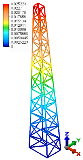

  1. Click  Analysis Analysis Run Simulation. The analysis proceeds and the model displays in the Results environment. By default, the displacement magnitude is presented initially.
  2. Select  View Navigate Orientation Isometric View.
  3. The Results environment shows individual results for each of the 80 time steps.  The commands in the Results Options: Load Case menu can be used to select among the available time steps. We will look at the displacement results from the last time step.
    • Select Results Contours Load Case Options Last Results to go to time step 80. The maximum displacement magnitude is 0.025 inches, as shown below.
