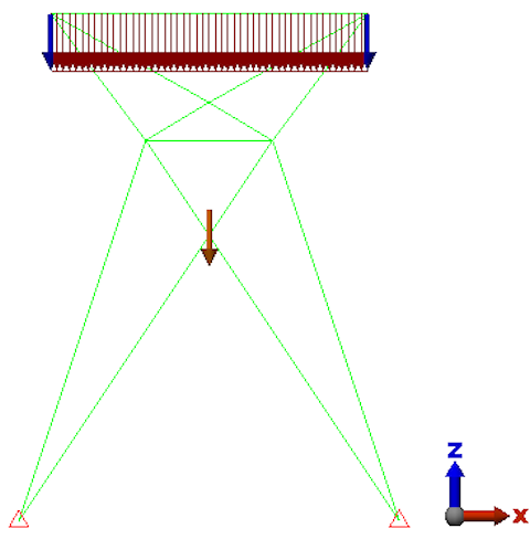

  2. Select the file, Beam Tower Stress Results.ach, and click Open.
    • Select the directory where you want the file to be extracted.
    • Click OK. The model opens in the FEA Editor environment, as shown below.
