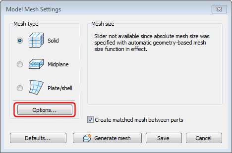

In this step, we define and generate the mesh on the model.

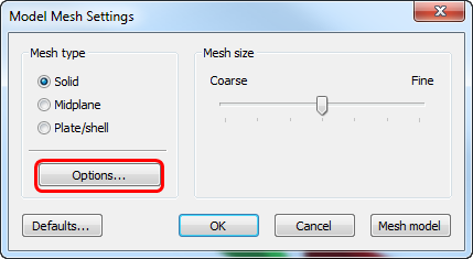

1. Click Mesh 3D Mesh Settings.
2. Click Options....

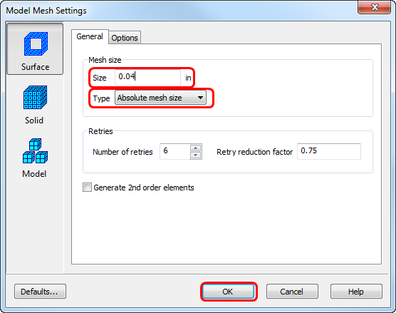

3. Set the Type to Absolute mesh size. Enter a size of 0.04, and click OK.

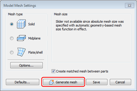

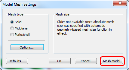

4. Click Mesh model.

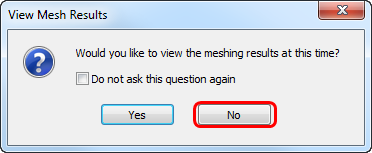

When asked if you want to view the meshing results, click No.

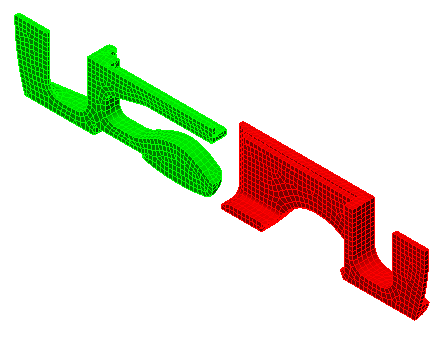

What it should look like…
