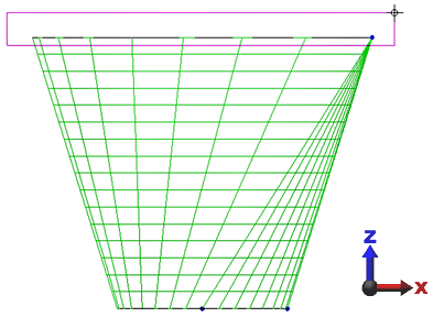

  2. With the  Selection Shape Point or Rectangle and  Selection Select Lines commands active, click and drag to draw a rectangel enclosing the top edge of the model.

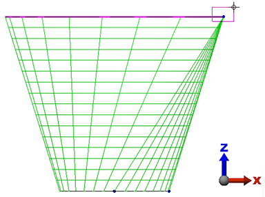

  3. Hold down the Ctrl key and draw a rectangle around the upper right corner of the model.
    This  removes the lines along that straight edge from the selection. We do not  want to copy these lines because that would produce a wall in the middle of the cylinder.

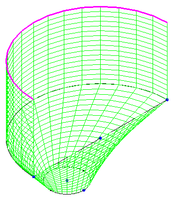

  5. Click  View Navigate Orientation Isometric View.
The model  displays as shown in the following image.
