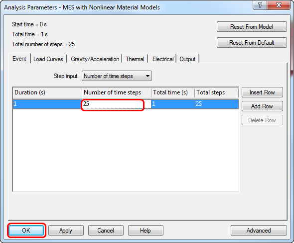

Set the Analysis Parameters
In this last step before starting the analysis, we define how the analysis will run. Specifically, we set the number of time steps to run.
1. Click Setup Model Setup Parameters.
2. Change the Number of time steps to 25, and click OK.
