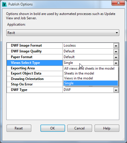

This table describes the publishing options available for Revit.
Option |
Description |
DWF Image Format |
Specifies whether the file is lossless or lossy. |
DWF Image Quality |
Specifies whether images in DWF are exported as PNG files (Default) or a compressed JPG format with quality settings (Low, Medium, High). |
Paper Format |
Specifies the paper format (ISOxx, ANSIxx, ARCHxx) for 2D views/sheets. |
Views Select Type |
Specify which view(s) you need to publish.
Exporting Area |
Specifies export of area properties separately from the geometric representation, so that individual rooms and room data can be viewed with facility management software (such as Autodesk FMDesktop), or DWF markup software (such as Autodesk Design Review). |
Export Object Data |
Specifies export of instance and type properties of objects in the exported views. See Exporting Object Data to DWF Files in the Revit Help for more information. |
Drawing Orientation |
Specifies whether drawings are landscape or portrait. |
Stop On Error |
Specifies whether the job processor stops when encountering an error. |
DWF Type |
Specifies whether the created file is a DWF or a DWFx. |
