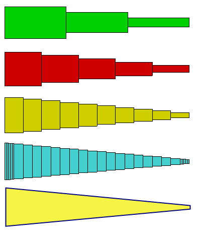

A series of linearly varying beam cross-sections can be created using the Variable Cross-Section Wizard. Each beam element has a different cross-section dimension based on interpolating the two user-specified end dimensions. The wizard creates a stepped beam that approximates a tapered beam. Any user-defined shape (rectangle, wide-flange beam, channel, pipe, and so on) whose dimensions can be entered in the normal cross-section library dialog box can be used for the variable cross-section.
 Figure 1: Variable Cross-Section Beam - four different mesh densities are shown to simulate a tapered beam with a variable height (bottom figure).
