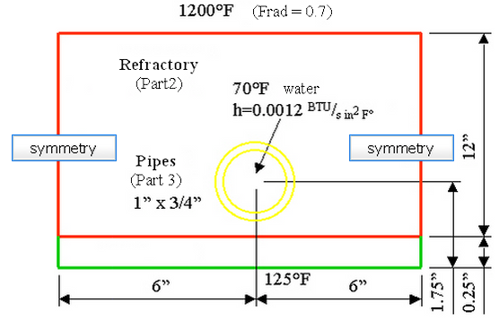

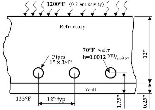

Given: A water-cooled, refractory wall in a furnace is subjected to the conditions shown in the following figure. Assume that the cold face remains at 125°F.
Find: The heat gained by the water per foot of pipe.

Each cross section is identical. A 2D planar analysis can be performed. Due to symmetry, only the cross-section around a single pipe is modeled, as shown in the following. The outline of each material is drawn, and the model is meshed with the 2D mesh generator.
Wireframe of Model (Not to Scale)

- Start a new sketch. Right-click Plane 2 <YZ(+X)> in the Planes branch in the tree view and select Sketch. The sketch plane is shown with the grid. Choose YZ<+X> for 2D elements.
- Add a rectangle for the wall using the Draw
Draw
Rectangle command. Ensure that the Part number is set to 1 and the Use as Construction check box is selected. Enter the first corner at (0,0,0) and the second corner at (0,12,0.25). Click Apply to finish the rectangle.
- Add a rectangle for the refractory. Set the Part number to 2. Enter the first corner at (0,0,0.25) (or snap to the existing corner of the wall) and the second corner at (0,12,12.25). Click Apply to finish the rectangle.
- Click the X button to close the Add Rectangle dialog box.
- To see the entire model, use View
Navigate
Enclose.
- Add the hole in the refractory with the Draw
Draw
Circle
Center and Radius command. Make sure that the Part is set to 2 and Use as Construction is checked. Enter the two points at (0,6,1.75) (the center) and (0,6,1.25) (a convenient point on the perimeter of the hole). Click Apply to finish the circle.
- The outside of the pipe is in contact with the inside of the hole, so the same size circle must be drawn on part 3. Set the Part number to 3. Click the two construction vertices created with the previous circle to add the new circle on top. Click Apply to finish the circle.
- Add another circle for the inside of the pipe. Use the center of the existing circle and the point (0, 6, 1.375). Click Apply to finish the circle.
