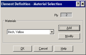

When the Material column is clicked on the Element Definition's Composite Laminate Stacking Sequence table, the Material Selection dialog shown in Figure 1 appears. The drop-down shows a list of all the composite materials that have been used for any lamina (ply) in any part of the model. Selecting an existing material and clicking the OK button will apply the chosen material to the current lamina.
Figure 1: Material Selection for Composite Elements
When the Add button is clicked, the standard material library interface will appear. Choose a material from an existing library, or choose [Customer Defined] and enter custom properties. This will add a new material to the list of composite materials available for the model. If you choose a material and edit the properties, you can enter a Name which will appear in the drop-down box. Note that this name (and associated properties) are not used outside of the composite element material selection.
When the Modify button is clicked, the standard material library interface also appears, from which an existing material can be selected, or a [Customer Defined] material can be used. The difference between Modify and Add is that the original material selected in the drop-down is replaced (or updated) with the new properties entered when the Modify button is used.
