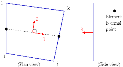

| Figure 2: Determining the Element Normal The edge-on view of the plate element is shown. |
| Figure 3: Local 1 and 2 axes for Plate Elements The dots along the side of the element are at the midpoint of the side. |

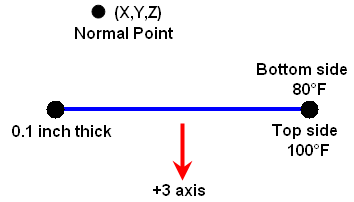

| Delta T thru thickness | = (Ttop - Tbottom) / thickness = (100 - 80 °F) / (0.1 inch) = 200 °F/ inch |
| Figure 4: Temperature Gradient Through a Plate Element | |
