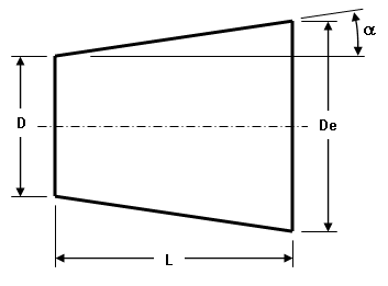

On the Geometry tab, specify the length, diameter (at -X end of cylinder) and taper angle of the cylinder. The centerline of the cylinder is on the X axis, and the end on the -X side is at the origin. The taper angle is defined as tan(angle a)=[0.5*(End Diameter - Diameter of cylinder)/(Length of cylinder)]. A positive taper angle means that the diameter is larger at the +X end of the cylinder than at the end specified (Diameter of cylinder (D1)).
Key:
D = diameter of cylinder (user input)
De = end diameter (calculated)
L = length of cylinder (user input)
α = taper angle (user input). Tan(α) = (De - D)/2/L
Figure 1: Tapered Cylinder

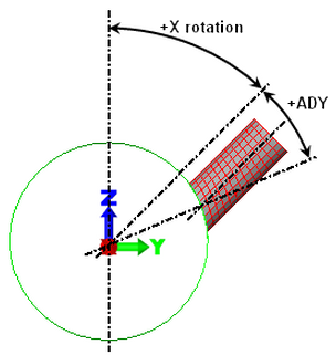

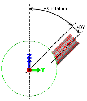

    • X rotation follows the left-hand rule to rotate the nozzle about the X axis to the point of intersection. That is, a negative angle rotates the nozzle about the +X axis. The Offset method then moves the nozzle off of the X rotation axis. See Figure 2.
    • The Offset method drop-down box is used to indicate how to specify the offset of the nozzle out of the plane of the X rotation. (If the X rotation were 0, the offset would be in the Y direction.) If the Distance option is selected, specify the distance perpendicular to the X rotation plane in the Nozzle's offset distance (DY) field. If the Angle option is selected in the Offset method drop-down box, specify the angle at which the nozzle intersects the cylinder in the Nozzle's offset angle (ADY) field. See Figure 2. This value follows the left-hand rule, so a negative angle rotates the nozzle about the +X axis.
      Offset of nozzle by distance
      Offset of nozzle by angle
      Note that the nozzle centerline is parallel to the centerline defined by the X rotation angle. When the offset is 0, the nozzle is perpendicular to the vessel. When the offset is nonzero, the nozzle is no longer perpendicular to the vessel. By using a combination of X rotation and offset, a nozzle can be created with any desired orientation.
      Example Vessel with known position of nozzle at angles α and β.
      Input into PVDesigner.
      X rotation = α-β. ADY = β.

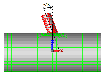

    • The nozzle can be rotated about the Y axis so that it is not parallel to the YZ plane. Specify the angle in the Angular rotation of nozzle (AR) field. Note that this value follows the left-hand rule, so a negative angle rotates the nozzle about the +Y axis. See Figure 3.
      Figure 3: Rotation of Nozzle About Y Axis.
      A positive angle is shown. Note that the angle follows the left-hand rule.

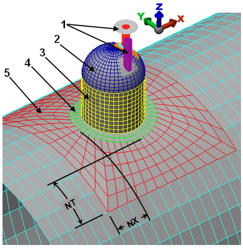

For the mesh around the nozzles, transition region, flange, repad, and heads on the nozzle, modify the nozzle of interest to display the Particular Nozzle dialog, then go to the Mesh tab. In addition to specifying the number of divisions, the size of the transition region around the nozzle to cylinder intersection is controlled by the Ratio of transition to cylinder diameter input. The dimension of the transition region, measured from the nozzle (or edge of the repad if included), is equal to or greater than the ratio input value times the cylinder diameter. The actual dimension of the transition region is adjusted to fit the mesh on the cylinder. See Figure 4.
Key:
1 = nozzles on head
2 = head on nozzle
3 = nozzle on cylinder
4 = optional repad on the cylinder
5 = transition region on the cylinder
NX = distance between nozzle (or repad if it exists) and end of transition region in the axial direction. NX>=Ratio*cylinder diameter.
NT = distance between nozzle (or repad if it exists) and end of transition region in the sweep direction. NT>=Ratio*cylinder diameter.
Figure 4: Transition Mesh Between Nozzle and Cylinder
