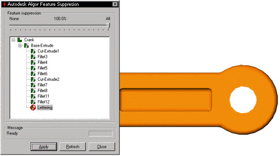

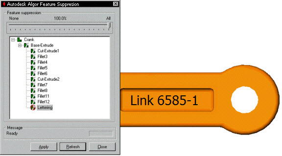

Showing the Autodesk Simulation Feature Suppression window along with the part
The lettering object was suppressed.
After suppressing the unnecessary details, the Autodesk Simulation Feature Suppression dialog box can be closed and Start Simulation can be selected from the Autodesk Simulation pull-down menu to transfer the part without the suppressed features.
